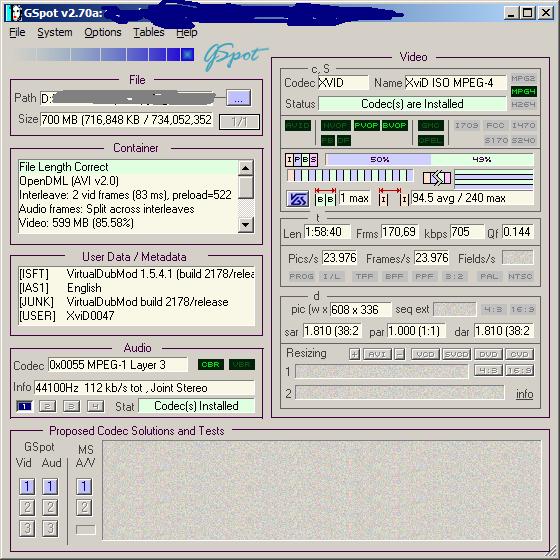

    The GSpot program says that the codec used is XviD ISO MPEG-4. Does this help?

    Take a screenshot of GSpot and post it here.

    This is the screenshot:

    Latest news: it seems that is works with DivX encoding; the XVID codec is the big problem; does anyone know what can I do to play AVI files encoded with XVID?

    Some Xvid encoding will likely work also, the only way to know for sure is through trial and error. Since there isn't anything that you can do with the player to make it play the files, you have to make the files compatible with your player.

    All the recent DVD models by Philips use a MediaTek chipset. This chipset will play XviD just fine as long as you don't use any "goofy" seeting like GMAC etc. and it is rare that XviD encoding use such "goofy" settings as the people in the "know" encode to be as close to DivX spec as possible in order to ensure DivX hardware compatibility.
    If you can't get XviD playing on a modern Philips then you did something really wrong with the encoding.
