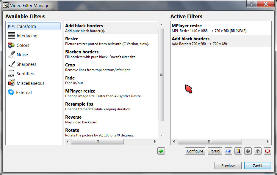

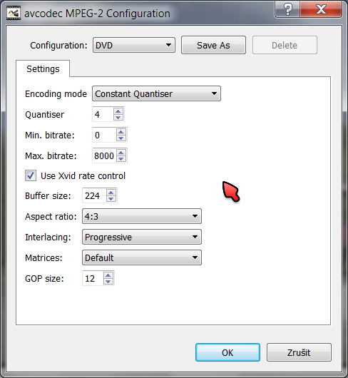

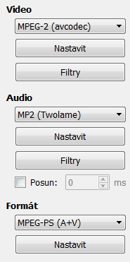

    I just tested it and yes, Avidemux has problems to play the video correctly. However, it looks like it does not have any influence on the output video.
    I tried AVCHD video from my Canon HF10 and also loaded some video from DVD using MediaInfo to find out the appropriate settings:

    Then I set Avidemux like this - see attached screenshots. And the result looked OK (do not have standalone DVD to test it). Here is the MediaInfo output for the file:

    However, I think there always be a quality loss, whan converting AVCHD to lower resolution DVD VIDEO. You cannot use some HD format like MKV?

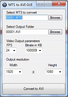

  24. i made small application that uses ffmpeg.exe from http://ffmpeg.org/download.html
    it makes it allot easier
    try it out
    Download ffmpeg.exe and place it in the same folder with my application, otherwise it will give u error and exit.
    ure welcome
