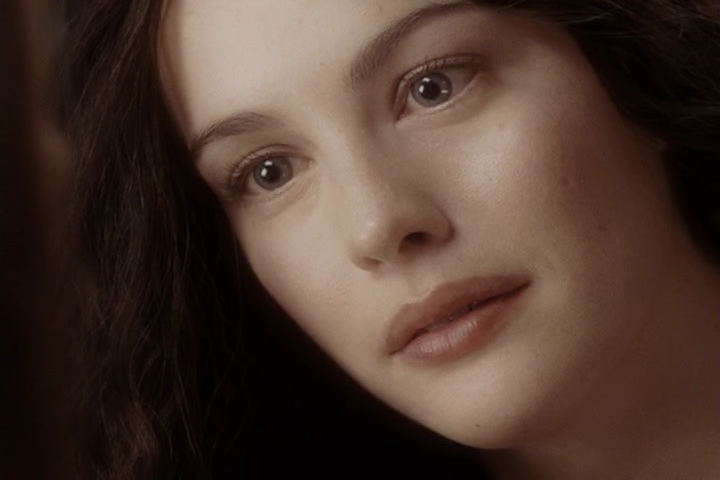

    Here are 3 tests I did. The first is DivX at 2400 kbps, the second is DivX at 4856 kbps and the third is DVD at 5042 kbps.

  8. You might include the original source frame as a point of reference.
    Nov 2002
    Not sure if this will upload. It's a PSD file of the three frames. If not I'll upload BMPs.
    dvd-1.psd
    Nov 2002
    Bitmap images for those who don't have Photoshop...

  12. Thx for the little comparison DarrellS
    In my opinion, the differences are minimal between the DivX encodes (at least based on those stills) do not justify 2x the bitrate. Personally I would just archive the orginal, since HD's are so cheap.

    You can see a very slight blur on the DivX files compared to the DVD and both Divx files look exactly the same even though one is over twice the file size.
