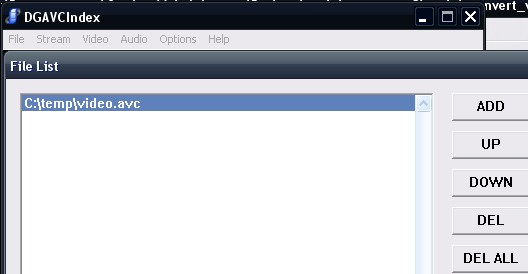

Then you can load the elementary video stream in DGAVCindex
Read the docs on frameserving the resulting .DGA file via Avisynth. -
