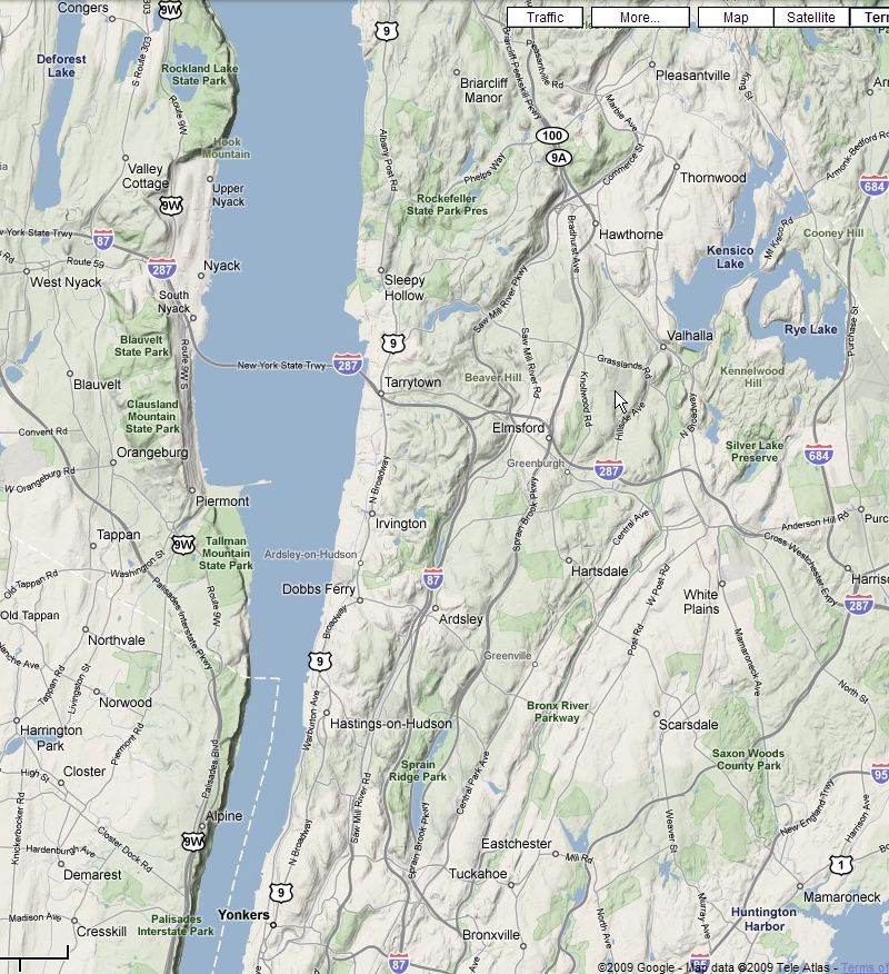

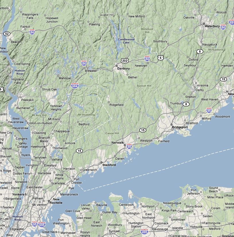

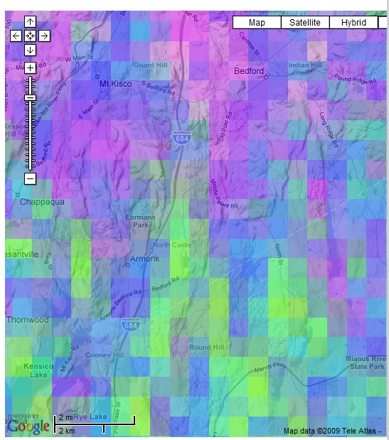

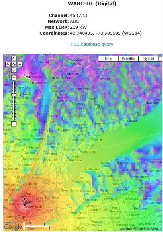

    Annother tool for antenna research.
    Google now has great topo maps called "Terrain". These help ID obsicals between you and the transmitter. Zoom in for elevation detail. Google Earth allows you to turn these sideways.
    I think these might be of help to VHelp up in Ct.

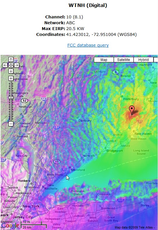

  17. Member vhelp's Avatar
    Mar 2001
    New York
    Actually, I'm in Westchester county, New York, not Connecticut. But since I can't get any signal channel(s) from NYC, I have the fortunate alternative (lucky me, I guess) of receviing Conneticut stations because I pointed my antenna at a different direction. Actually, what I did was set my HDTV receiver (at the time) to display the signal strength on screen (for each channel) while I turned the antenna until I noticed the bar (or precentage) rise. Well, I didn't have a listing at the time, so it was hit and miss but fun hunting around for new channels. But the efforts were worth it. Anyway, as of right now, I am receiving two major stations:
    NBC 1920x1080i/30fps, and
    ABC 1280x720p/60fps
    ..from Connecticut. As I stated earlier, I also found *two* new stations that were recently added to the HD scene. So that added to the excitement since there is very little channel offerings over antenna to begin with. The more the merry, right!
    My suggestion to anyone having trouble obtaining broadcast stations in your supposive-areas, should try and point your antennas in the opposite direction--better yet, find a website that lists channels *nearest* to you and point to the location(s) in those listings. Or find a website the lists them easily for you. If anything, it may be a good excercise, plus, you may be surprise at what is out there for watching.
    -vhelp 5001

    VHelp, Minni,
    Check out the coverage maps at TV fool. They have online lower resolution maps and detail torrent downloads.
    This is the current WABC-DT Ch45.
    http://www.tvfool.com/?option=com_wrapper&Itemid=80&q=call%3dWABC-DT
    Zoomed in
    http://www.kiva.org/about

    This is WTNH-DT ABC10 New Haven

    I don't know why mini insist on aiming antenna at NYC only, when could aim it at Conn. and NJ for at least some stations. Might get better reception/signal strength than I am and/or more channels..i don't know..only have point antenna eastward for Conn., and SW-ward for NJ to see..i get nothing from NYC..nothing.
    I'm curious about the wattage standards..and what to expect from all the broadcasters, and when they go official to digital and turn on/up their wattage power to their fullest.
    I'm assuming that all are suppose to be at a standard: 1500kw, ie..i made that value up.
    Q: what is the standard (fullest) wattage that broadcasters are suppose to have ?
    if WABC-DT 45 (7.1) is currently operating at 219kw now, and I can' get anything from them, as of now: I wonder if, when they are at full power, will I receive them (given their current 219kw rating) after feb/19th.
    That WTNH 10 (8.1) (currently @ 20.5kw) is the channel I mostly get the clearest and strongest, with nbc the more trouble-some at times. And the stranger thing is that it is so low in wattage right now but I get it better than most other channels (nbc for ie) so it would be interesting to see how much better the signal strength I do get from it. Sometimes its between 80-100 percent, others, less, but does hickup a lot at night during certain programs that I want to watch: Lost, ie..I couldn't watch it last Wed night because the naighbor next door to me was on the cell phone most of that night..is usually at work, but because of the snow that evening/night, work was cancelled, I guess.

  24. Member edDV's Avatar
    Mar 2004
    Northern California, USA
    The main issue is whether you have unobstructed line of sight to the tower or are blocked by buildings or terrain. On the TVfool listings you will see line of sight "LOS", "1-edge", "2-edge" etc. to describe terrain blockage. VHF channels bend around hills better than upper UHF.
    Each station has its power and antenna plans in the FCC database. The FCC regulates to "effective radiated power" which is a combination of antenna design and raw transmitter power. Also, VHF and lower UHF need less power to get the same service contour vs. upper UHF.
    WABC transmitter filings:
    http://www.fcc.gov/fcc-bin/tvq?list=0&facid=1328
    They have so many because of temporary issues on the Empire State Building. It looks like the Feb 17 CH 7 configuration will have 11.69 kW ERP @405meters height. There is a CP for an antenna change to 505 meters with 5.59 kW ERP. They are trying to reach the same contour.
    TV = Analog NTSC
    DS = Special Temporary
    DX = Digital Auxiliary (backup antenna)
    DT = Digital Television Station
    CP = Construction Permit
    WTNH-DT Ch 10 New Haven shows no change post Feb17. It will remain 20.5 kW ERP @ 342meter antenna height.
    http://www.fcc.gov/fcc-bin/tvq?list=0&facid=74109
    See contour maps here. These represent the goals for coverage. They don't factor terrain or building blockage issues.
    WABC-DT @405m http://www.fcc.gov/fcc-bin/FMTV-service-area?x=DT1247154.html
    WABC-DT @505m http://www.fcc.gov/fcc-bin/FMTV-service-area?x=DT1251321.html
    WTNH-DT http://www.fcc.gov/fcc-bin/FMTV-service-area?x=DT989921.html
