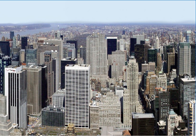

    The Empire State Building makes an interesting TV mast. It was originally designed to be a dirigible terminal.
    Last time I was up there was in the mid 90's. By then the large station's transmitters were mosty at the World Trade Center. Each station had lower power backup transmitters at the ESB but most of the antennas up there were in support of microwave TV news feeds and FM radio. After 911 there was a scramble to get larger analog and DT transmitters up there for improved coverage.
    old antennas before addition of DT.
    This is the view looking up the Hudson.
    New Freedom Tower ~2012
    http://www.glasssteelandstone.com/BuildingDetail/439.php

    Expect poor service from antennas on the Empire State Building for the next few months while the analog antennas are taken down and new digital antennas are installed.
