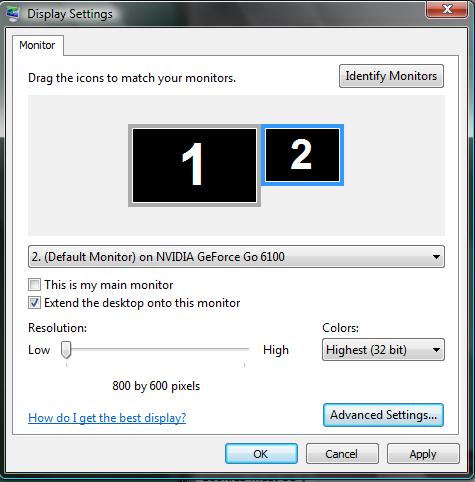

You should be seeing something like this after reboot. You would finish settings under "Advanced Settings". The menus from there are unique to each chipset driver.
