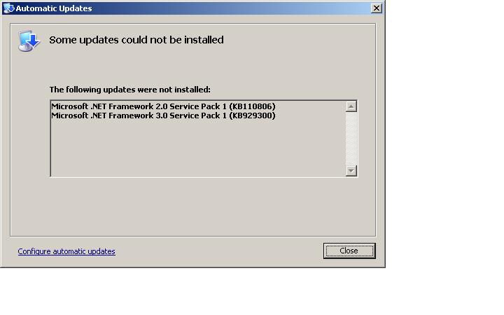

    Feb 2007
    Also I tried installing Windows Updates and it has the .Net Framerwork 2.0 SP 01 and .NET Framework 3.0 Service Pack 1 but they won't install it just takes a long time then Fails to install...
    Please help
    Jun 2005
    Portugal
    Your .NET framework is definitely corrupted, it has broken links in your System Registry
    Before anything else you must totally remove .NET 2.0 from your PC
    Try to remove it in ADD/REMOVE programs in Control Panel
    If it isn't listed in there you must do it manually
    Follow this tutorial for manual removal :
    http://support.microsoft.com/kb/320112/
    or google for
    framework manual uninstall
    Feb 2007
    I used a .NET Cleanup tool to Remove in Completely then installed the one you gave me from the link
    it seems to work...thanks a bunch
