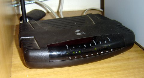

    Firstly, I think I have a router and not a modem. From the front it has lights for Power, four ethernet connections (E1-4), Wireless, USB, DSL, and Internet.

    avz10, that does appear to be a modem/router.
    Gateway: 10.0.0.2 is your router IP address
    IP address: 10.0.0.4 is your desktop PCs address
    IP address: 10.0.0.1 is your laptop PCs address
    Those addresses are from NAT (Network Address Translation) That comes from a router.
    I don't know if you can log onto it, but try typing 10.0.0.2 into a web browser as the address, hit enter, and see if a router page comes up. It may have a logon name and a password. That's where you would configure LAN addresses. But it looks like the router is set for DHCP to create them automatically, so you may not need to do anything with it.

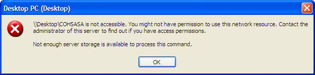

    If I go Start-My computer-Entire network-Microsoft Windows network-I get MS Home. If I open that, I see the Tower Desktop PC. If I open that, I see the shared folders on the tower desktop. If I click on those, I get the error message, which I took a screenshot of.

  11. I guess you mentioned it in the first post, but just to clarify - BOTH pc's can access the Internet with no problem? I think we've been chasing the wrong issue.
    Specify OS for each unit.
    When mentioning Desktop or Shared folders, specify WHICH PC you are referring to. When you are describing two or more PC's, each has a Desktop, therefore "Desktop" is insufficient to identify. "Laptop desktop" or "tower PC desktop" makes it clear.
    Input User Name and Password on BOTH pc, this sounds like a USER RIGHTS issue rather than a Connectivity issue.
    Login Name and Password on PC-1 must be identical to a valid Username and Password on PC-2, otherwise access will be denied. You don't actually have to login with the same name, you just have to be able to. If you are logged in as JohnSmith with password "jones" on PC-1, you MUST be able to login the same way on PC-2.
    If I want a single key to open both the front door and the back door, the locks have to be set up to allow this.
    Verify that BOTH pc's are in the MS Home workgroup.

    Thanks for the reply. I'm again on the road, and I think you are right, it is not a connection issue, but a user rights issue, since the one (the laptop pc) is one from work.
