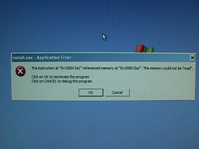

i'm getting something similar..this message appears when the puter is shutting down..it started about a week ago but it doesn't effect the shutdown..any ideas what this might be..?
ButchX, that appears to be a program installer trying to run. Unfortunately, the name shown isn't of much use. But do a search for 'Install.exe' on the computer, all files and drives, and see what shows up.
If you haven't installed anything recently, I would run some antivirus/malware detection programs. Anything that wants to install at shutdown seems a bit suspicious.
