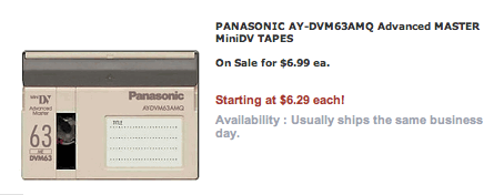

I am currently leaning towards the Panasonic Ay-DVM63 AMQ "Master Mini DV" from TapeStock.com. They seem to be $2.50/tape cheaper than my usual supermediastore.com.
Thoughts?

The AY-DVM63 AMQ is an excellent choice.John Miller -

The AMQ is a good product, especially for the price. I would recommend it for HDV as well.
Shameless plug: we got it cheap.
