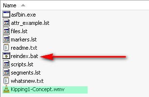

  5. Member Soopafresh's Avatar
    Jan 2004
    Download this and unzip
    asfbin1.6.1.703.zip
    Drag your WMV file into the unzipped folder and double click "Reindex.bat"
    Complete

    Soopafresh!
    That asfbin repair tool helped me with this exact same problem. And it took seconds. Thank you!!!
    Nightowl
  8. Just like to echo nightowl's thanks. A great solution! I found that it didn't work at first but then i changed the file name to a shorter one and it was perfect. Superquick too

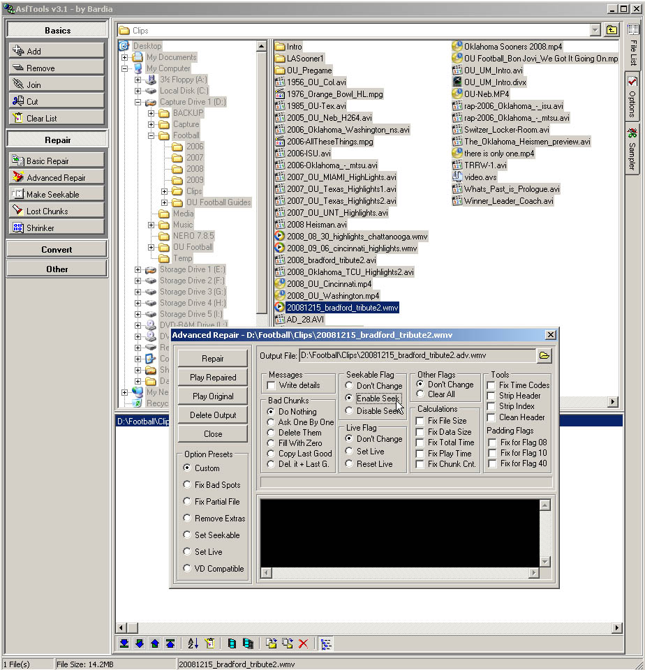

    I didn't know you could do that. I've been using asftools.
  10. Note that high compression codecs typically store a list of keyframes at the end of the file. That list is what lets them quickly seek to anywhere in the video. When that list is missing, even if the rest of the video is intact, it's much harder to seek within the file because the player would have to go to the first frame, then read every frame of the video until it reaches the requested frame. This can take many seconds, even minutes with a long video. Most players don't bother with this and will just ignore the seek request or start playing from the first frame again. Re-indexing is the process of rebuilding that index and adding the new index to the end of the file.
