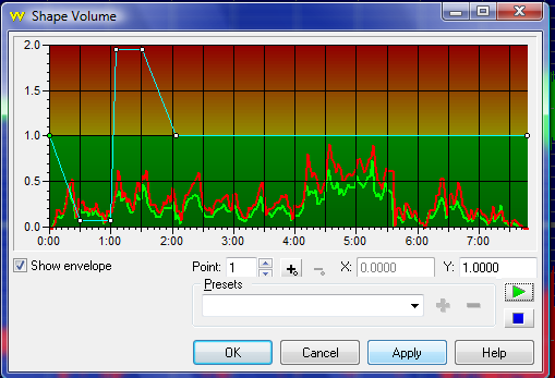

I fired up a GoldWave trial to check it out. Here's how it looks like you would do it:
Load your video, then click "Effect", then "Volume", then "Shape Volume..."
In the box that pops up, you can tick the "Show envelope" button to give you a picture of your left and right channels to better guide you visually on where you are in the track (the red and green graph on the bottom of the picture below). Now just click on the line in the center at 1.0 to set a control point. Move it up or down to raise or lower the volume. Click to set more control points and move them around as needed. Note that the graph on the bottom does not change to reflect your volume adjustments, it's just there to show you where the loud/soft parts are.
In the example above, I've dropped the volume down to almost nothing between 30 seconds to 1 minute, then went very loud for the next 30 seconds, then back to 1.0 at 2 minutes to put things back to the original volume.
To preview your work, click the "Point" box back to 1 and hit the play button on this window (setting the point to 1 starts the preview playback just before your changes begin; you can adjust that if you want to check a different change further along in the track). When you get it like you want it, click "Apply" then save it.
Volume shaping is simply drawing a line across the audio wave. The higher the line, the louder the volume. The lower the line, the lower the volume. Goldwave gives you a zoomed out view. I always found it difficult to get really precise with it. But Cool Edit Pro lets you zoom in on the audio and put the line segments exactly where you want them... down to the sample. I'd imagine that Audacity lets you do the same thing. It see,s very similar.

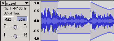

Audacity lets you see the effect of the envelope on the waveform so it's easier to match up peaks, etc., as you draw the envelope. I didn't see an option for that in GoldWave; you'd have to adjust by listening/trial-and-error. I'm not a regular GoldWave user, though, so I may have missed it. Audacity:
