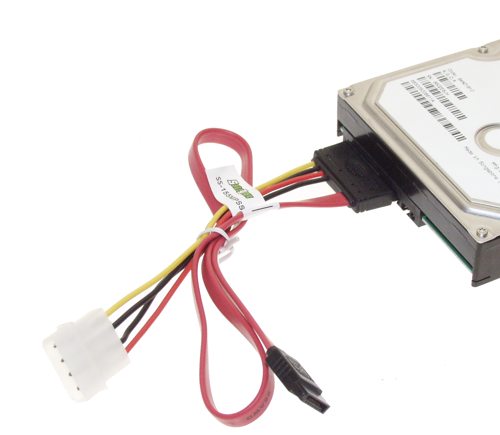

    Most drives now are SATA 2 (SATA 300). But they are backward compatible with SATA 1 (SATA 150) drives and controllers.
    Some SATA drives can use a 4 pin Molex Power connector, but most use a SATA type power connector. You can get an adapter to a Molex power plug if needed. They don't usually come with the drives, but some drives have that and a SATA data cable included.
    For installation and formating, look here: https://forum.videohelp.com/topic346464.html and here: https://forum.videohelp.com/topic346453.html
    The adapter and SATA cable look similar to this:

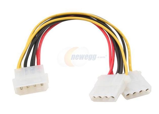

    Molex Y adapter. You split off one of your existing power connections to your drives. You can also get these with a SATA power adapter end.
