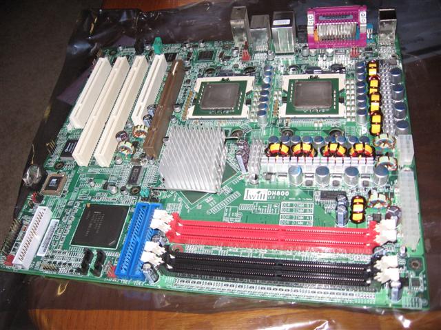

    Well I've been dealing with some bad caps that need replacing on my main workstation's board making cold boots difficult and lately causing random reboots. I swapped in a much larger power supply, a PC Power & Cooling 850W monster, to alleviate some of the power issues due to the caps. Since the DH800 is well-known in the enthusiast community for being one of the best workstation boards built on the 875 chipset I didn't want to just get rid of it but replacing caps is more than I can handle and nobody locally would touch it so my only option is to mail it in for repairs.
    Instead I've found a replacement board with better chips. The revision 1.2 board fixed the cap issue and allowed the chips to be overclocked without pin mods like on my rev 1.0 board. And since the seller was parting out his system I got a pair of 3.2 Gallatins with the board.
    Unfortunately this means PC surgery and downtime and I hate having to re-install Windows after doing so not long ago to try to resolve the reboot issues. I know you need to re-install Windows on a new system board but what if the board uses the same BIOS and only the processors are faster? Should I try just swapping the board/procs and see how stable XP stays afterwards?

    My worry isn't so much the board but the processor difference. The board is the same model, only the hardware revision is different. The changes include better capacitors and the ability to OC the chips without the pin mod that was needed for my old board. The BIOS used on both boards is identical. The old procs are 130nm 3.06/533 with 1MB L3. The new ones are 90nm/3.2/533 with 2MB L3.
    I already have everything backed up from the last time I re-imaged which was about 3 months ago. I just hate re-installing all my applications and getting the preferences back to my liking

    should be ok to try. after the switch if windows doesn't "find" any new hardware(other than faster cpus) on the first boot you are probably good to go. you can always re-install the m.b. driver infs and force windows to scan for hardware changes if it doesn't seem quite right.
    CPU changes don't really affect Windows much. I've done it before, no problems. Changing the motherboard always fubar'd my IDE/SCSI drivers and the power settings (locks on shutdown). Always have to reinstall OS.

    I had to reset the CMOS which caused an issue with the PCI devices and I lost one for some reason but otherwise Windows has been running fine. I'll post CPU-Z screenshots later.
