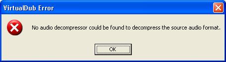

I often extract the audio from AVI files using Virtualdub. I often do this when I want just a clip from a video file. Sometimes if the source audio was encoded in VBR, I need to extract the entire audio as a decompressed WAV, and then use that WAV file with the video in order to avoid a sync issue. I have been doing it for years without fail.
However, just recently it has been giving me an error. It says "No audio decompressor could be found to decompress the source audio format."
It worked just fine for years. I have changed no settings at all, neither in Virtualdub or in Windows. I have not installed or uninstalled anything new. Does anyone know of the solution?

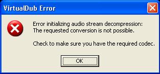

I did that, and now I get a different error than before in VirtualDub:Did you try loading (or reloading) the LAME 3.97 Release ACM codec?
http://www.rarewares.org/mp3-lame-dshow-acm.php#lame-current-acm
Right-click on inf file and click install
