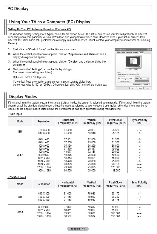

    Page 44-46 of your manual.
    The following resolutions are supported by the 4661F.
    The lower ones are for the HDMI port and the upper ones when using a DVI-I to VGA connection.
    http://www.kiva.org/about

    Regardless, you have a second option using your DVI-I to VGA adapter and a VGA cable to the 4661 PC port. The page I gave you in the manual tells you how to set both ports and the resolutions the PC display card must send.
    The 4661F will allow 1920x1080p over either cable.
    Yes my friend, you are right. The CRS from Samsung told me exactly what you told me. The problem consists on resolution. The CRS from Samsung told me that this HD Samsung TV can get the signal form PC at 1920x1080p or over !!! This is the point!!!
    So, how can I change the resolution at 1920x1080p in Windowa Vista? Because your suggestion is based on Windows XP. This my real problem now...why I can not get the signal form PC.
    One more thing: If I will chenge the resolution to 1920x1080p over, wiil this change will affect my PC monitor? I am gonna lose the signal on my Pc monitor? Thanks a lot.
    NOT over 1920x1080. Read the manual. 1920x1080 is max. DVI-D single link also maxes at 1920x1080 and that is also the native resolution of of the 4661F.
    You need to hire someone that knows how to set a computer display card to dual monitor mode and set output resolutions. Each card is different once you get past the generic screen and into advanced settings. We've already told you the display settings are under desktop right click - personalize.
  28. Displaly resolution setup in Vista is exactly the same as in XP.
  29. Originally Posted by jagabo
    No, sir. After opening display settings, I can change the resolution no more than 1280*1024, that is the maximum.
  30. That is the maximum for your current monitor. When the HDTV is detected by Windows you will be able to change its resolution to 1920x1080.
