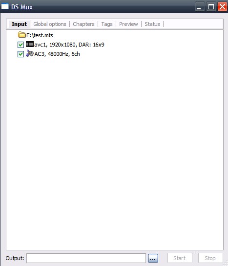

    What is the best way to "convert" those avs and ac3 files I get into mkv container without quality loss?
    And another question. AVCHD camcorders usually make several .mts files, is these a way to bind them or append them so I only get 1 mts file?
  22. Member Soopafresh's Avatar
    Jan 2004
    Hi s0tt0
    You can join your MTS files via the command line like this:
    Copy /b 00001.mts+00002.mts+00003.mts output.mts
    The only lossless method I can think of to convert .MTS to .MKV is to use an app called Gdsmux.exe , found in the Haali media splitter folder. No need to use the batch files, you only have to add the .MTS file and save as a .MKV
    You can also use RipBot 264 to convert to MKV, but it will re-encode the video
