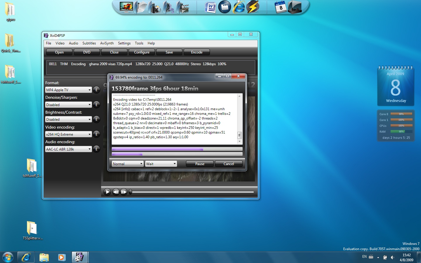

    thanx for suggesting me to use XVID4PSP as it gives as good results as you said... BUT: it takes 16GB file to make it to .mp4 about 1 day and couple hours or as i decoded 8GB before which took about 12 hours...this seems to be ages..maybe i'm doing something wrong? or is this how it's supposed to be? take a look at the picture added and you'll see what settings i use. maybe you could give some suggestions?
    thanx a lot for your help!

    @ Soopafresh
    thanx for reply
    can i ask you if you use Xvid4PSP yoursef? and what settings do you use to get the best quality? i've got Canon HF10 and the camera is superb but i'm strugling to find the best quality that can be played on any PC after decoding. also ther's problem with Vegas Studio 9 which doesn't seem to be supporting .mp4 as i would like to do some editing. any suggestions here as well?
    thanx for your assistance

    @ eckoeze@yahoo.com
    if you check my screenshot above of the settings i use with Xvid4PSP then you'll know what to select. in my mind it gives very good results! maybe coding is a bit slow (that's laptop's fault) :) but results are really good! by the way i've got Canon HF10 so it's almost the same as yours and i think with those settings you'd be happy with the result. Post your findings. Maybe you'll find some better solutions ;)
