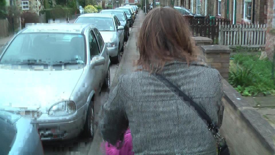

@fishywishy - I suspect there is something wrong with your decoder and/or playback chain. The horizontal lines maybe there from interlacing but there should not be any vertical lines
What camera is this from?
What software are you using to "convert" or to "view" ? The image should be 1920x1080, but your attached bitmap is 1440x1080 - so whatever software you are using is not honoring the 16:9 DAR flag
Can you upload a small sample of the unprocessed source to a free hosting site? e.g. mediafire -
'07 sony hdr-cx7Originally Posted by poisondeathray
i used the avchd_convert_v7.zip and the vimeo one as well. i also used voltaicHD to wmv. i viewed the mts with oxygen avchd player. all show these vertical lines (click the image to full size and youll see them)
youre correct, i captured that image before i knew how to correctly use avchd_convert_v7.zip. however even at 1920x1080 i get those lines. when i get home ill upload a .mts file
much appreciated
oh and the cx7 records @ 1440x1080 and then strecthes it to 1920x1080 when its played or converted to raw to edit. thats where im guessing these lines are coming from -
heres a quick 5 second clip
http://www.mediafire.com/download.php?tm1mzgy4zng -
Yes what you are saying about the DAR is correct. If you use MPC, for example it will display properly because it acknowledges the flags and displays as 1920x1080. The frame size is still 1440x1080 in avisynth or editing programs because they usually assume 1:1 square pixels
However, your sample has vertical lines despite using different decoders/renderers/software. I suspect something is wrong with your camera and/or your settings. For example, you can download other hdr-cx7 clips that do not have these lines (just the regular horizontal interlacing ones)
http://av.watch.impress.co.jp/docs/20070711/zooma314.htm -
wow, yeah my camera must be screwed up. guess thats why it was an open-box
thankfully theres no restocking fee

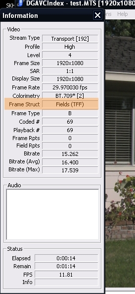

Thats strange, when opening an MTS file withOriginally Posted by Soopafresh
DirectShowSource("file.MTS").info()
the info filter shows BFF. If I use assumeTFF, it shows "TFF assumed".
Does info() reads some file field thats overlooked by assumeTTF()?
-- Brunori -
Open up your file with DGavcindex. That'll be the more accurate method of determining field order.

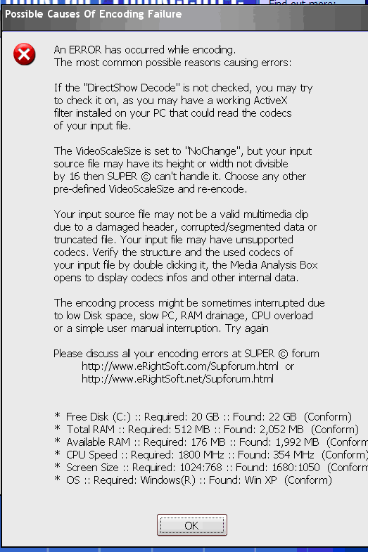

Soopafresh... I've installed the latest FFdshow (i.e. 12/05/2008) but DirectShow is failing. It's creating an MPG file within which is contained the error message (one of the more creative methods of error reporting I've encountered.)
Essentially, the message is "DirectShowSource: couldn't open file XXXX.MTS: Cannot play back the file. The format is not supported."
This tells me my system isn't configured to use FFdshow as its default codec for MTS/h.264 files.
Also noteworthy...
1) I installed a 14-day trial edition of CoreAVC over a month ago. It's still installed but has expired.
2) I tried throwing my MTS file into GraphEdit but the application was unable to create a graph from the file and asked "Have you installed all necessary filters?"
Thoughts? -

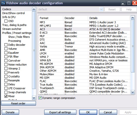

1) Uninstall CoreAVC (if it's installed)
2) Download and Install the Latest FFdshow Beta http://sourceforge.net/project/showfiles.php?group_id=173941&package_id=199416&release_id=439904
3) Enable h264 decoding in FFdshow. You'll want it to say "libavcodec"
4) Download and install Haali Media Splitter (aka Matroska Splitter)
5) At this point, you should be able to play your MTS files with Windows Media Player or MediaPlayer Classic. If you don't have audio working, try to turn in on once again with ffdshow settings.
