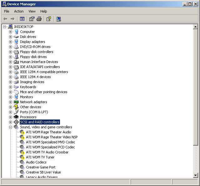

now device manager looks like this..
so...what now?
Manually update the drivers for each device (right click on it) from what's on the CD.

nope... it says can't find better drivers than what is alrady installed
