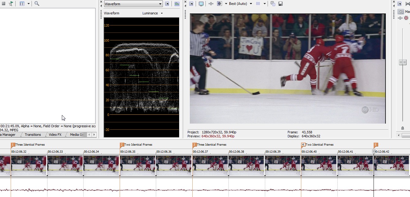

My experience with 720p shows frame repeats 2 then 3 in the nominal case.
23.976P starts ABCD
59.94P repeats AABBBCCDDD
But I've noticed on ABC series that frame repeats vary either for seeming editorial reasons or as you say for time compression. FOX seems to follow normal 2-3 frame repeats (e.g. "House").
I just cap ABC as is for now at 59.94. This results in about 7.5GB/hr before commercial removal or about 6GB/44min after commercial removal. Ideal decimation back to an ABCD sequence would reduce that to ~2.5GB/44min.Recommends: Kiva.org - Loans that change lives.

Not really. Exact duplicate frames take almost no bits to encode in an MPEG stream.Originally Posted by edDV
True if you recode. But raw cuts with programs like HDTV2MPeg2 preserve the original GOPs for something better later.Originally Posted by jagaboRecommends: Kiva.org - Loans that change lives.

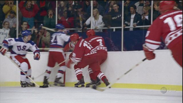

ABC-DT, FOX-DT and ESPN-HD (cable) use 1280x720P at 59.94 fps 24x7 for everything.
PBS distributes to stations at 1920x1080i/29.97 but many locals convert to 1280x720p/59.94 plus two 704x480i/29.97 subchannels (second local +Vme).
All the rest use 1920x1080i/29.97.
Conversion of film source 720p/59.94 to 720p/23.976 is a frame decimation process.Recommends: Kiva.org - Loans that change lives.
http://www.kiva.org/about -
Frame decimation strategies vary but often follow this method
Film Frames ABCD @ 23.976 fps
720p Frames AABBBCCDDD @59.94fps
drop every other frame (SelectEven/Odd in AVISynth script)
drop even #frames
A_B_B_C_D_
Drop second duplicate frame
ABCD
or
drop odd #frames
_A_B_C_D_D
ABCDRecommends: Kiva.org - Loans that change lives.

I just use SelectEvery(5, 0, 2) or SelectEvery(5, 0 3). One of those two will work regardless of where in the dup pattern the capture starts.Originally Posted by edDV
AABBB CCDDD - either
ABBBC CDDDE - either
BBBCC DDDEE - SelectEvery(5, 0, 3) only
BBCCD DDEEF - either
BCCDD DEEFF - SelectEvery(5, 0, 2) only -
