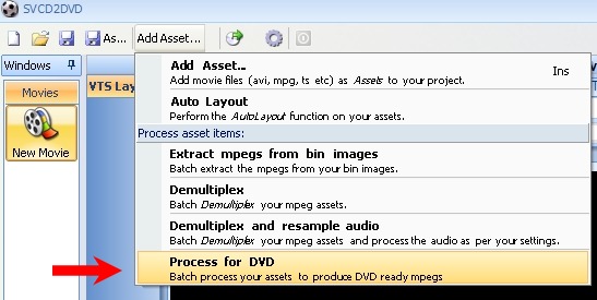

    To change the subject slightly, is there any way to have S2D just convert from AVI to MPEG2 without having the DVD files made? I often do not need the last part of the conversion.
  5. Originally Posted by Neil Goodwill
    Dwight
    "A positive attitude may not solve all your problems, but it will annoy enough people to make it worth the effort."
    - Herm Albright
    www.martialconcepts.com
    Sep 2006
    Thank you ever so much.
    What a numpty I am, I didn't look properly at that drop down menu!
