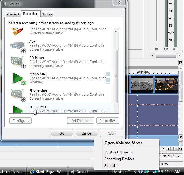

This should be a question for Easycap USB 2,0 tech support but try this.Originally Posted by Eric544
Right click on the speaker icon and select "Recording Devices". See if your capture card is there.

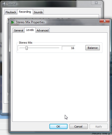

If you double click on the device or right click "Properties" you may see a level control like this.
