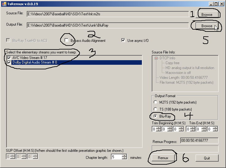

    Create your Blu-Ray file structure with TsRemux. Browse to your xxxx.m2ts and open it. Now deselect Bypass Audio Alignment (very important or you wont have audio in your Blu-Ray player). Select all streams. Select Blu-Ray. Browse to where you want to create the directory and choose a name for your folder. Finally, hit the Remuxer.
    You’ll end up with a BDMV and CERTIFICATE folders. Your video will be in “STREAM” sub-folder in the “BDMV” folder.

    Check step 4 of my guide - "Now deselect Bypass Audio Alignment (very important or you wont have audio in your Blu-Ray player)". The same thing happened to me when I didn't de-select "Bypass Audio Alignment"............
