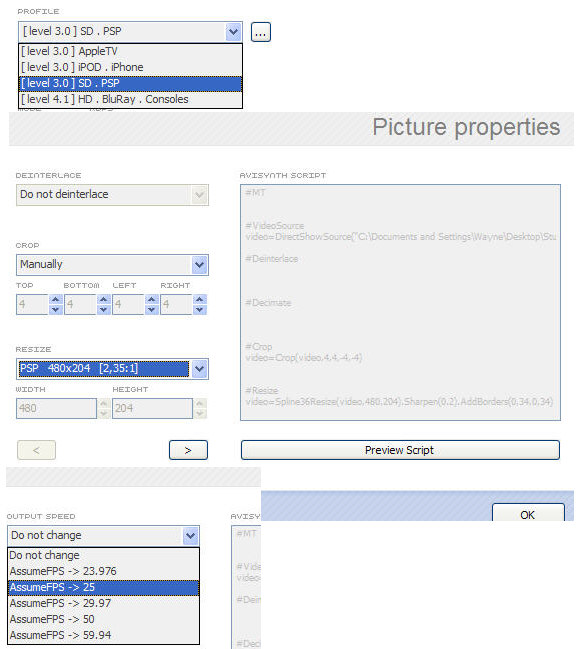

 If you want an easier (i think better) way for psp conversions, I suggest ripbot264 which has a psp profile. You can also crop, resize, and change output speed in the options easily (it makes a script for you). Here is a sample collage of some of the options:
 Good Luck
