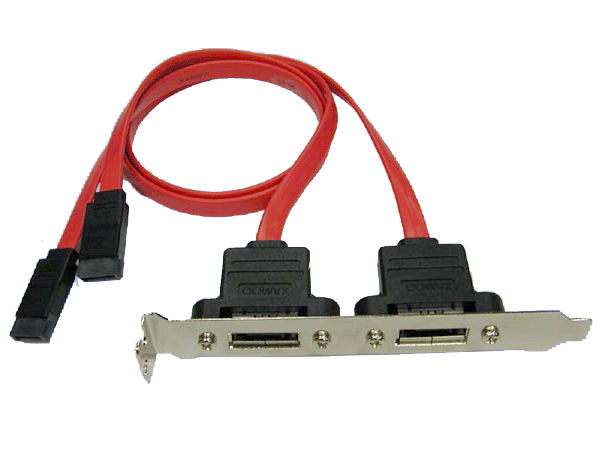

    For 1TB I'd even recommend one of those external SATA bays that have 2 drive slots and a RAID controller. You can get them with an eSATA connection to run to a free SATA port on your current system (with an adapter plate for the back of the PC) or to a simple SATA controller (HBA?) in a PCI slot. The nice thing about having the mirrored array external is the ability to turn it off when not needed and move it to other systems (especially if your current PC should die a horrible and dramatic death as has happened to me in the past). Moving an existing mirrored array to another system is possible in such a case but sometimes it won't work even with the same controller being used to manage the mirror.

    I use two PROMISE SATA300 TX4 PCI SATA II Controller Cards for eight 320GB WD drives in one of my video servers. No RAID, though. They have been working with no problems for about a year. I've haven't seen a cooling problem either, and the drives are about 1/4" apart. SATA drives seem to run cooler than the equivalent PATA drives. The case does have a front intake fan that moves some air over the drives.
    An external case does have some advantages, independent power supply and better cooling, and of course, a bit easier to set up if your computer case is cramped. You can get SATA controller cards with external SATA or eSATA connectors, or just use an internal card and a SATA PCI slot adapter from the internal card. SATA can use up to 1 meter cables, eSATA almost twice that. Just something to consider.
