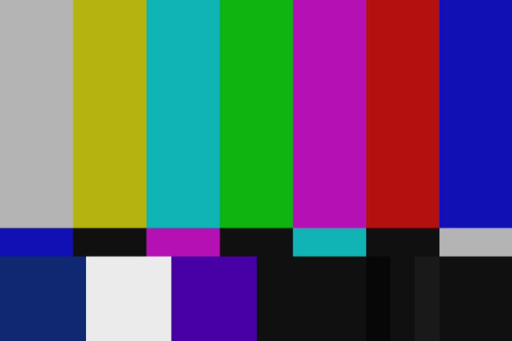

BTW, here's a DV format color bar generated by Vegas. Load it to your DV timeline in any editor.
Set monitor black to the "pluge" ---------------------------------------------------------------------^
Match pluge to second bar. Bar three should be slightly brighter.
Set white to taste.Recommends: Kiva.org - Loans that change lives.
