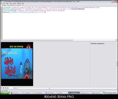

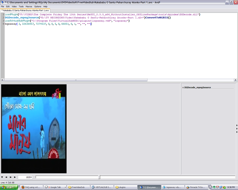

  5. I have tried with LOGOAWAY filter(from VIRTUALDUB)........I haven't got any error,but couldn't get the filter effect.
    this is the screenshot........

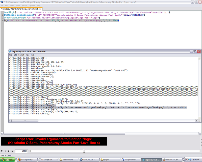

    I have also tried with LOGO filter ,but I got error,
    although I have used it in avisynth script directly with no error.
    But when I try to 'import" the LOGO.avs in the original script(contains filters),I get the error
    another interesting thing when I try to encode the script with Megui,it previews ok,but give me error while in virtualdub encoding with same script goes nicely.

  7. @PuzZLeR
    what you have said,I have done all this steps,I haven't only used "peroll".from the 1st Screenshot,it is clear that I haven't got LOGOAWAY effect on the video.
    I have used successfully the script of alpha blended logo in avisynth,but when I load "LOGO" filter from virtualdub,I get error as I have given the 2nd Screenshot.

  11. Originally Posted by PuzZLeR View Post
    What you can do is create a .vcf file of your project and its settings from VirtualDub.
    VirtualDub -> File -> Save processing settings...
    Then open it up in NotePad and cut and paste what it says. Maybe the solution is in there for us to help you out.
    If you see the 2nd screenshot,I have already done that,It is the only process to do........
