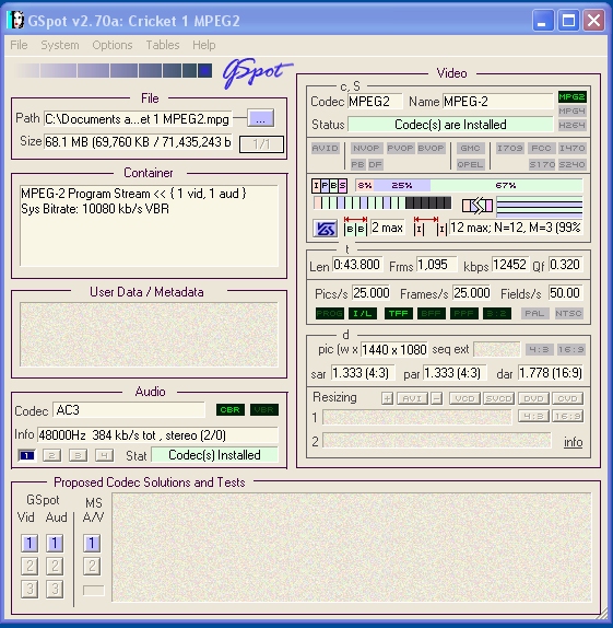

That warning looks like the program is not detecting any audio for the file. Can you open the file in Gspot and post a screenshot of the result?

Many thanks for your assistance. Interesting that you noted the issue with audio. I have found it difficult to always have the audio play from my HD files from TV source (my only source of HD btw, so I don't know if any other HD source would behave similarly). I have had both PowerDVD and AVS media inform me that their software cannot play (or edit, in the case of AVS) HD files so I put the problem down to their software. Your comment makes me think there may be another problem lurking somewhere! I can play HD files through K-lite's Classic Media player and generally they play well through Aver's software (much more reliably the longer I have been using the latest download). I do have the latest drivers for my Realtek AC97 audio too. As you can see I have run the file through GSpot (interesting name for such a program...) Looking forward to your comments.

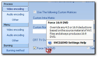

I also had to force the DVD to 16:9 by choosing the following in settings:

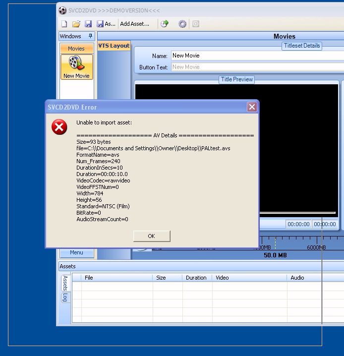

Hmm - seem to have hit a snag and don't know why, with the file I originally sent you and any new file I create (such as the one with the error message in the attached jpg). Could you please have a look at the error message - I am concerned that I now have the avisynth file seemingly creating NTSC rather than PAL and I'm getting the 0 Audiocount again- and I don't know why as I haven't changed any settings in SVCD2DVD other than the forcing of the 16:9. Bewildered.
Ok. Is the sample you sent me coming out NTSC too?
Well, I seem to have got things working! I found that by giving the file a different name to the one generated by the TV card and then putting the .avs extension that I can load the asset into the program. That should put an end to it, although I haven't burnt a disk yet as I actually need to buy a few extra DVD disks. Hopefully the files will burn witha as much success as you had with the file I sent you. Many thanks for your help.
Burnt a DVD tonight. Picture AND sound! Couldn't get it to search, so will play around with the instructions and see if I can burn it with different attributes and get a better result. I do find it odd that the only way I can get an attribute to initially load into the program is by changing the original name, then saving it with AVS. Anyway, slowly getting there!
