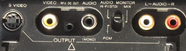

3. PCM Stereo (12 bit, 32KHz) were two additional digital audio tracks allowing 4 channel recording. All the PCM models I've seen allow only two audio channel output at any one time. These models have a three way switch to select audio tracks.
* HiFi - This gets the AFM stereo pair
* PCM - This gets the PCM pair
* Mix - This gets a mix down of AFM and PCM audio to two output channels.
If you don't have the switch, you probably don't have PCM audio.
