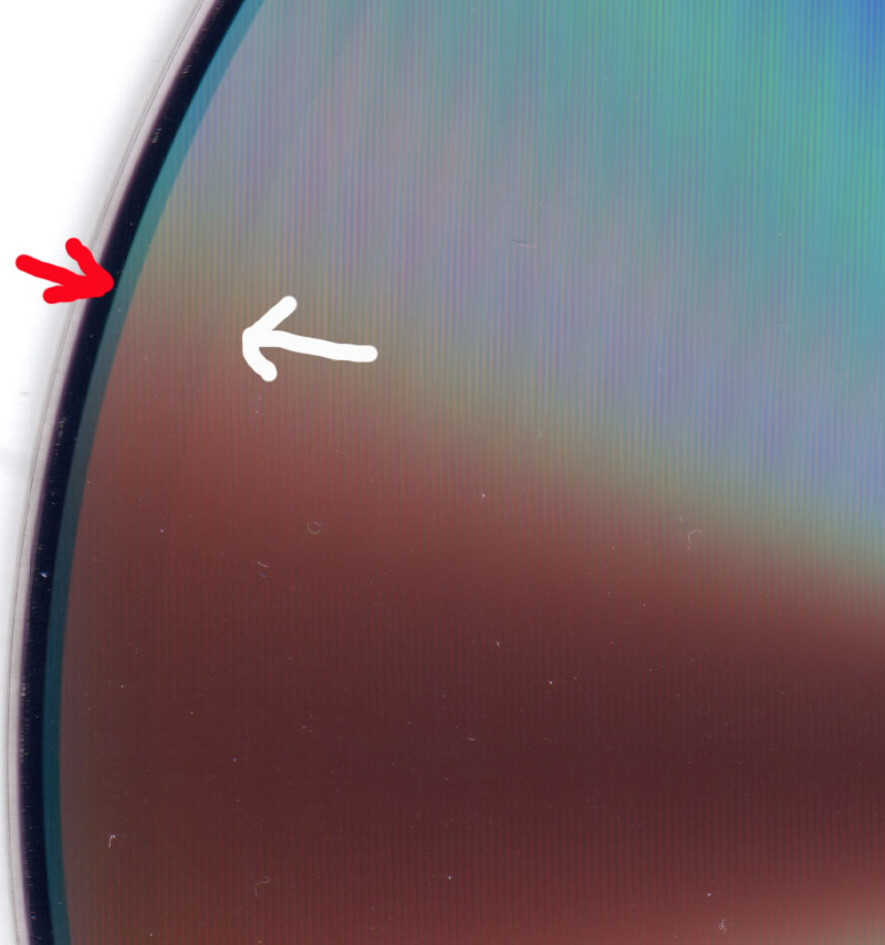

I've been having problems with SMS TY Value line white inkjet printables 8X, at least 5 or 6 coasters per 100-Pack. It records the whole disc but when I play the movie there is a missing piece at the end. I perform a disc scan and there are bad sectors at the end from an X point (where it starts) until the very end.
I realized when I turned the disc upside down that the coasters have a "ring" of a different color/tone on the outside of the disc.

That "ring" is a zonal burning ring, and is caused by a burner. That outer ring is likely caused from a 16x burn. At what speed are you burning these discs? Zonal rings are normal.

It was recorded at 8x. In this particular one the ring is at the end of the DVD and there are 20 min. "missing" of the movie at the end of it. BUT I also had a movie that could only be played until half of its length time and the ring started at half of the disc......Originally Posted by lordsmurf
