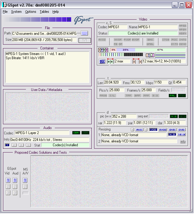

  2. Open one of the files with GSpot. Post a screen cap of the display.
    Feb 2008
    Here the screen of file I tried burning.
  4. It looks like you have a standard VCD MPEG file. There doesn't seem to be anything unusual about the audio -- MPEG-1 layer 2, 224 kbps.
    Have you tried playing with any other players? Like VLC, KMPlayer, MPC? Those three have their own MPEG video and audio decoders so they don't rely on installed system codecs.

  14. I just noticed something about the GSpot image you posted earlier. I hadn't noticed before because I only looked at the audio information. But the video is captured at PAL VCD resolution and frame rate (352x288, 25 fps), not NTSC VCD (352x240, 29.97 fps). You will not be able to make an NTSC DVD from this VCD data without converting the audio and video. This may be the reason for the error messages.
    If this is something you can record again you should do so with the proper NTSC settings. If you can't record again MovieFactory should be able to convert it.
    Is it only this one file that is giving you problems? Or does it happen with all files you record?

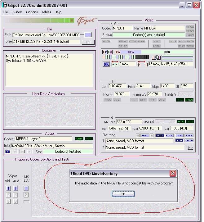

    I don't know how it got onto PAL last time, but here is the file I have been messing around with for a while.
    (Also, I just copy and pasted the error message I keep receiving in the blank box of the Gspot pic.)
