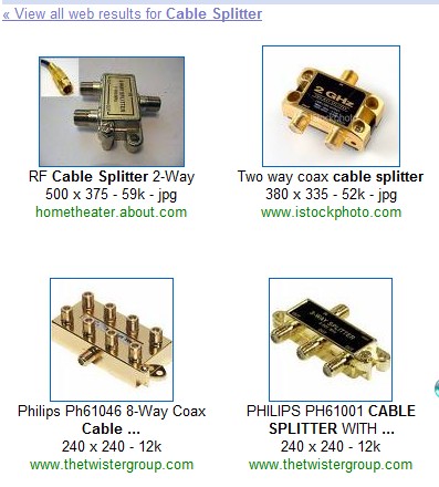

    Looping the cable through the cable box may be possible. Talk to the cable support people about this as it varies by cable box.
    I use a splitter upstream of the cable box to all devices. I also feed the s-video + audio outputs from the cable box to the various recording devices.

    What is this splitter upstream? Is special?
    Second point: the DVD recorder or VCr can tune the channles if you connect them with RF line cable and not other sources like Svideo, AV etc.

    Typical cable splitters. 2x and 4x are usually available at places like Walmart or KMart. Make sure "bandwidth" is at least 1GHz.
