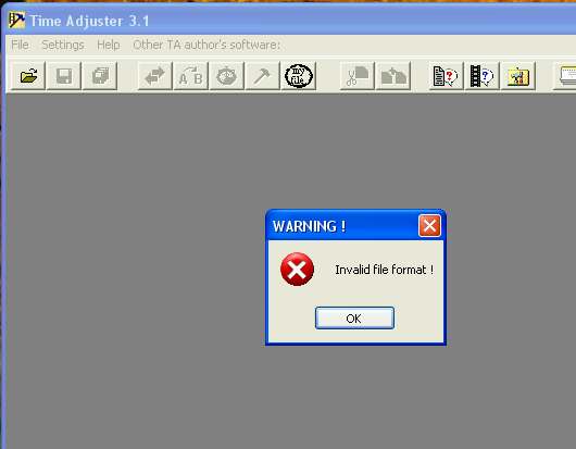

    and downloaded the described MKVextractGUI.exe folder software package and used that software to extract out the srt subtitles from the mkv file. I then used DVD Flick and loaded the mkv file along with the srt subtitle file and the resulting DVD was perfect. My question is this: just as an experiment, I looked at the srt subtitle file in Notepad and it looked fine (see screenshot 1) . However, (as an experiment) I tried to load the srt file into Time Adjuster, but I got an error message (see screenshot 2). I have always been able to load srt files into Time Adjuster so I don't understand why I am getting this error message. I tried to "fix" the srt file with SubResync so that I could then load it into Time Adjuster, but I was unable to get SubResync to correct any problem with the srt file. Can someone tell me why I can't load this srt file into Time Adjuster and how I can "fix" this srt file so that I can load it into Time Adjuster?

  5. I used UltraEdit to remove all instances of and (html tags) and I still got the same error message when trying to load the srt file into Time Adjuster. I then used the Edit>Select All > Copy > Paste function in Notepad and duplicated the original srt file (with html tags) and made a second seemingly identical srt file. The duplicated srt file (with html tags) opens perfectly in Time Adjuster. The original and duplicate srt files appear to be the same. Can someone tell me why the original srt file (named test.srt) will not open in Time Adjuster, but the duplicate (named test1.srt) opens perfectly?

    Yup, just like I suspected: garbage in the first 3 positions of the original file. Can only be viewed in hexadecimal mode. Take a look:
    either file in text mode:
    1
    00:02:28,040 --> 00:02:29,339
    test.srt in HEX mode:
    00000000 EF BB BF 31 0D 0A 30 30 3A 30 32 3A 32 38 2C 30 1..00:02:28,0
    test1.srt in HEX mode:
    00000000 31 0D 0A 30 30 3A 30 32 3A 32 38 2C 30 34 30 20 1..00:02:28,040
    notice in test.srt the HEX characters EF BB BF and the corresponding ascii characters  on the right side.
    Any file viewer or file editor (including UltraEdit) capable of HEX display will reveal these characters.
    How they got there? might be the MKVextractGUI inserted them or the srt file was created this way to begin with.
    For future reference, UltraEdit, in HEX mode will let you delete those characters or just use your method.
