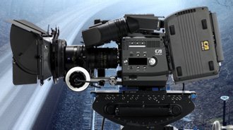

    You don't get to 1920x1080p until HDCAM-SR format (440Mb/s) although AVC-Intra will support 1920x1080p @100Mb/s in the future.
    The Viper Venum (Thomson)
    The Sony F-23
    This is a great overview of the high end.
    http://cinetaur.googlepages.com/hd24pdigitalcinematographylinks
