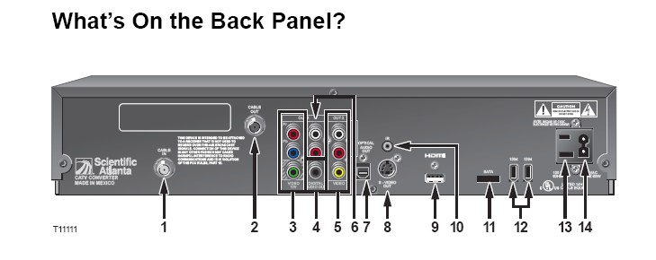

YES< I have the IEEE-1394 (Firewire) port on my PC, that I have not used yet.
However, my HD box does not have Firewire plug in back or front, Just Composite, RCA, HDMI, S-Video, Coaxial, SATA and a USB port for some reason.
It is a Scientific Atlantic box.
Should I request them to switch out my box with one that has Firewire? -

Sorry it was the 8300HD. You have two connectors on the back #12.
http://www.scientificatlanta.com/products/consumers/userguidepdfs/4003986.pdf
It says "May not be available on all models".Recommends: Kiva.org - Loans that change lives.
http://www.kiva.org/about -
That's strange, because I have that model box, and it does not have those ports.
What should I ask them over the phone? Somebody mentioned that they might not know much about the ports on the back. I have the 8300HD model, but those ports are not present for some unknown reason.
Could it be this cable company does not allow the use of firewire? -

My brother, who lives a few doors down from me, has the same model box with the IEEE ports.
I called the cable company about getting one with the ports, and they seem reluctant about letting me have one.. mentioning something about copyright laws with recording movies. I explained to them that I had no interest in recording movies with the device, and pointed out that I don't even have any movie channels on my account.

Maybe the firewire ports aren't active? You may have to find a secret setup screen on the STB.
The cable company has the menu option to silence the port by channel, but the FCC has mandated local channels must be active and unencrypted if the IEEE-1394 port is there.Originally Posted by jagaboRecommends: Kiva.org - Loans that change lives.

I just checked, it shows all of the outputs.Originally Posted by edDV
What is odd is the HDMI is disabled.
However, the Firewire is Unavailable.
Can I change this, or is this a setting set at the cable company, through the cable lines? -
Find and go through all the documentation on the box at the scientic atlanta site. They have extensive user menu pdfs. Also, enter the "business" side as if a cable company to find even more detailed documentation.Originally Posted by Chuck_Johnson
The box eprom is fully programmed via the cable. You can force a reprogram by unplugging a few hours or ask cable support to do it from their end. What you get is what they have programmed.

Scientific Atlantic blames the cable company, and the cable company blames them.
What should I do now?Customer Service,
The ports are disable due to Federal guidelines for copy write protection.
Your cable company writes the firmware for the box (operating system). The
software has the ports disabled.
Thank you,
SciAtl Support -
You're stuck. If the cable company turns off the port in their downloaded software, you can't override it.
