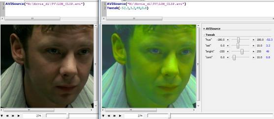

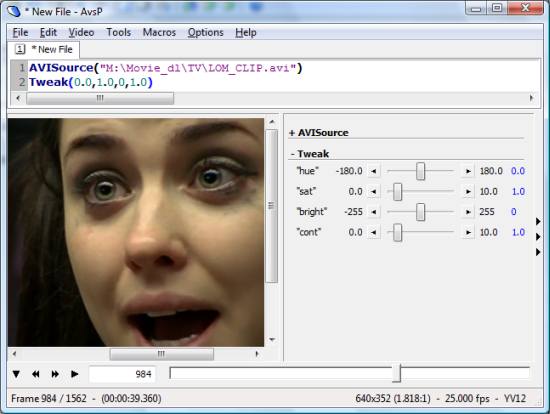

theewizard,
manono's Tweak recommendation is spot on, as always. For an easy preview, try this:
You mentioned you have Avsp. Just drag your video file onto an open Avsp window, it will fill in the 1st line for you. In the second line, type:
Tweak(0.0,1.0,0,1.0)
(These are the default values for hue, saturation, brightness and contrast).
Now hit F5 and avsp will open a preview window. Click on the "+" next to "Tweak" on the right and you will have a slider for each of the attributes above. Adjust each value to your liking; results appear instantly in the preview window. If you screw up, you can return the bad value to its default by clicking the blue number to the right of the slider.
Once you get it like you want, just plug that line into your avs and you're good to go.
To quickly compare the changed version to the original, you can open a new tab and drag the file into it, then just switch between tabs. -

OK , I just did a quick try, dropped my file in Asvp and followed your instructions
got the preview window and got the sliders, tweaker will do nicely, i use avisynth for this project, then experiment with the mpeg files of the wifes Olympic skating recordings

You mentioned sharpness above. To add that, just type this in as line 3:
Sharpen(0.00)
then hit F5 again and you'll have a sharpness slider, and so forth for other filters. As you probably noticed, AvsP will show you the default values as you're typing. You can control the resolution of the filters by increasing/decreasing the number of decimals in the script lines.
