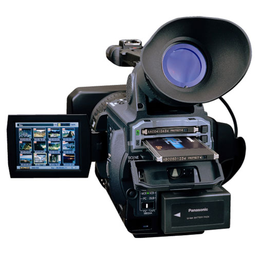

Panasonic AG-HVX-200 with P2 Flash Media

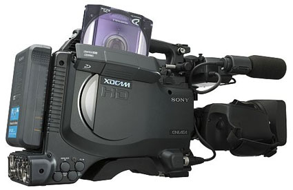

Sony XDCAM-HD with BluRay DVD media

Oh boy. I've read a lot about these but haven't seen such obscenely drool-inducing pictures of them. They look like something the Terminator or Judge Dredd would be seen with.Originally Posted by edDV
I'm still grinning from seeing them.
Thanks! -
The P2 Flash card can handle 100Mb/s DVCProHD format but at that rate a 50GB flash card would be needed for 1hr. External Firestore hard drive solutions are available to supplement the P2 cards.
