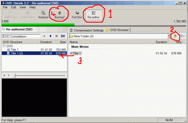

    Create the 4:3 dvd ready to burn. Create for as many titles as you need.
    Create the 16:9 ready to burn. Same as above.
    I have a fast machine so I would create a DVD folder for each clip.
    Open DVDShrink in Re-author.
    Browse to the first dvd folder and drag the title(s) to the left.
    Keep going 'til you have them all. Then click Backup!
    The output worked for me in PowerDVD V5.0
    These are 2 VHS conversions. First is 4:3 and the second is 16:9
    Checked with PowedDVD's Configuration/Information whilst both halves were running.
    Definitely different ARs. Played OK in my cheap cheap DVD player.
    Hope it helps.
