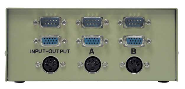

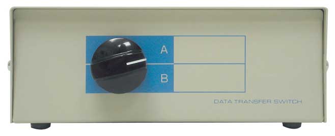

    The second KVM listed would make your life a bit easier.
    Or you could get the first listed one, and a second similar unit that also additionally switches the keyboard and mouse. The speakers I would just use two sets, but you could probably switch them with some boxes. You need to figure in cable costs also. You will need extension cables that match the sockets on the PCs, the switch boxes and the monitors. That could add to the overall cost.
    Those simple mechanical switches are cheap enough and work fairly well if you keep your cables short.
    One similar to this might work: http://www.computergate.com/products/item.cfm?prodcd=WSB1505092
    That's a US distributor, but it's probably built by the same company as the one you listed.
    Higher bandwdith = cleaner image at higher res (1280x1024, for example).
