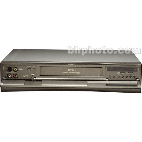

  17. Use caution if deciding to purchase a used or older VCR. Make sure it has been serviced. The tape heads, belts, etc. could all be worn. You don't know how many hours of playback it had. The JVC DNR is not mandatory. You can turn it off by setting the DNR option to "EDIT" mode. I've been using this mode for most tapes. The "auto" mode is a little too soft one some tapes and makes people have a plastic look. You can still buy new JVC decks with the adjustable DNR functions(soft, sharp, auto, edit) and line-TBC. Here is a digital deck a friend bought recently. I find it's output just as good as my JVC 9911u.
    JVC SR-VD400US
    http://www.bhphotovideo.com/c/product/285082-REG/JVC_SRVD400US_SR_VD400US_Pro_HD_D_VHS...er_Player.html
    [/img][/b]
