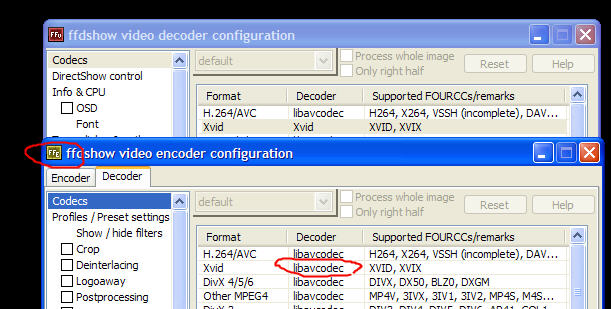

Have you enabled XVID in ffdshow VFW video encoder interface ? -

Just installed ffdshow (the 64bit version, albain's build called: "ffdshow_rev1785_20080116_albain_x64.exe" from here: http://sourceforge.net/project/showfiles.php?group_id=173941). But I'm not sure exactly what you're talking about when you say enabling xvid in the VFW config box... where do I do this? -
