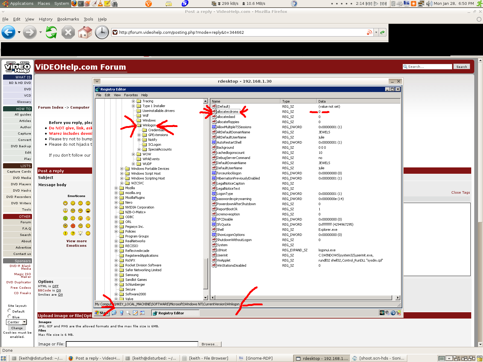

    Could be an ASPI error. If you've recently installed a burning app, especially one that does packet writing, this could be your culprit.
    You might also want to check the values in "allocatecdroms" in the registry. If it's 1, it needs to be 0.
    HKEY_LOCAL_MACHINE->SOFTWARE->Microsoft->Windows NT->CurrentVersion->Winlogon
