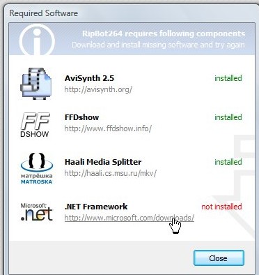

I am also having some problems with Ripbot264, it does not goes further than audio normalization...and when I select deinterlace, it says that a .dll file is missing. Should I run something first before using Ripbot? -

Then, I tried with Ripbot264 to produce a mp4 file compatible with PS3. It recognizes the audio mpa file, but not the video mpv. I have tested using the original m2t file for video input and the mpa file for audio input.
The program stays for a very long time stuck in the audio encoding phase and apparently does not continue processing. I have all necessary components installed and really have no clue about what is wrong... -
As I mentioned above, I don't think RipBot will work with AVCHD source files.
