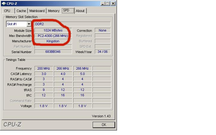

That statement is not yet clear. Are you saying you took out the original PC4300 and have replaced it with another stick of of 1 gb PC5300 so you now have 2 sticks of the same PC5300 ram and no PC4300 on that system?Original Memory: 1GB KINGSTON PC4300
Added Memory: 1GB K-BYTE PC5300 (I Bought 2GBS=2 Sticks with my Best Buy Stuff So I have 2 Sticks of 1GB)
If that is what you did then as long as there is no compatibility issue that should fix the ram problem. You can now concentrate on missing codecs and video driver issues. -
His statement is clear take a look at his CPU-Z picture closely, you'll see he is using 1gb of KINGSTON PC4300 & 1GB (unknown brand) PC5300. I know on P4/AMD pc's you could mix and match PC3200 & PC2700 RAM but I've yet to see mixing PC24300 & PC25300.Originally Posted by gll99
I know...And I do Understand that I have 2 Different Memorys...
So where can I purchase another PC2-4300 KINGSTON 1GB please post a link where I could get it for a good price...
And for all of you who keep telling me I know I have Two Different ones...It is obvious...And I was just asking should I take out the Kingston one and try using the 2 GBS of the K-Byte PC2-5300 Memory (I have two Sticks that are 1GB each of Memory but it is the one that doesn't have the Manufacturer name... -

If you have the manual for your motherboard it should tell you what RAM specs it will accept. If it says it will accept PC2-5300 RAM then you should be able to remove the original Kingston RAM and add in your two 1GB sticks. You could of course just go ahead and try it and see if it likes it or not.
Just try the 2GB's of the KBYTE PC2-5300 RAM which is faster than the KINGSTON PC2-4300 RAM. If the KBYTE's work well then there's no reason to buy another stick of the KINGSTON PC2-4300 RAM. I'd prefer the KINGSTON brand but if the KBYTE works for you then just use it.Originally Posted by sandman423
While this *might* be a memory incompatibilty issue, I doubt it. In my experience memory errors usually cause BSOD, or slow data corruption/errors in applications. I have also run different types/speeds/brands of memory on intel and amd systems without problems.
-He passed memtest
-If it was a memory issue, playback should be affected on all players, not just 1 or the other
-Other programs should show signs of corruption
-He pulled 1 stick and still experienced the problems (so would running dual channel somehow miraculously fix the problem LOL?)
To me, it looks more like a driver/codec issue.
Just my opinion,
Cheers -

Ok I looked in the manual and here is what it says...
ECS NFORCE4M-A
This Motherboard supports up to 32GB of system memory with DDR2 800/667/533/400 DIMMS
That is what it says...I don't even see 4300 or 5300 Listed... -
DDR2 533 is PC25300. Remove the PC4300. What's the motherboard model number? I'm just curious.Originally Posted by sandman423
As I mentioned remove the pc4300 ram and install the other pc5300 (533) into your computer and go from there.

How many ram slots on the mb? Did you put them in the right ones (1 and 2). You had one of these sticks in before and didn't get beeps so I suspect it's not pushed in properly or it's in the wrong slots.Originally Posted by sandman423
it is in slots 1 and 2...the very first slots that the original 4300 Memory was in...
I have 2 Orange slots and 4 Purple Slots I believe...they are both in the Orange slots -

your motherboard only has 4 memory slots, 2 orange & 2 purple. i looked at your motherboard manual and yes you can only use the APACER or GEIL 1gb sticks. did you build this computer yourself? it's always best to use the memory that the motherboard manufacturer recommends.Originally Posted by sandman423
As long as RAM meets spec and is not defective, specific manufacturer should not matter. Extremely rare that this is a problem.
Beeps means either defective RAM or not properly inserted, as mentioned. Just as a test, take ALL the RAM out and note the beep code. Not fully inserted should give same error as no RAM at all, different beep would indicate bad chip. Codes are no longer standard but that sounds like a short of some sort in the chip.
Since you now have reason to suspect at least ONE module, simplify life by installing only ONE at a time. PC no work, bad RAM. No question which chip, there is only one installed. There is absolutely no need to install more RAM until you get all other issues resolved.
Dual-channel is somewhat over-rated but just get two matching chips, 400 or better, preferably 800. That way you just might not have to throw them out the window at your next mobo upgrade. One 533 is better than two 400's.
