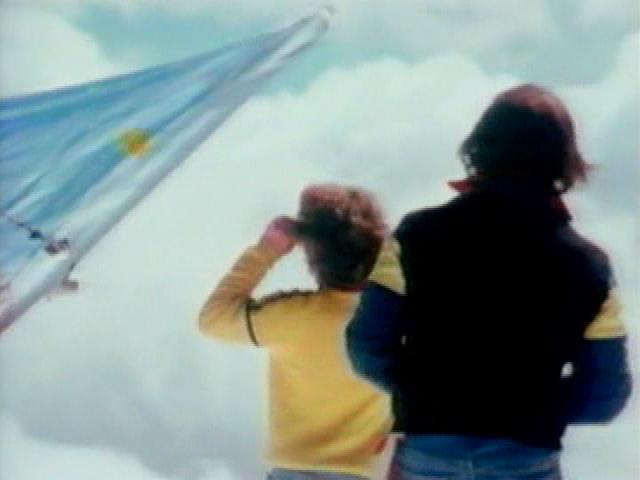

    Here are some of the things I notice and would appreciate any ideas as to the cause.
    Green/Yellow spot on hangglider wing.

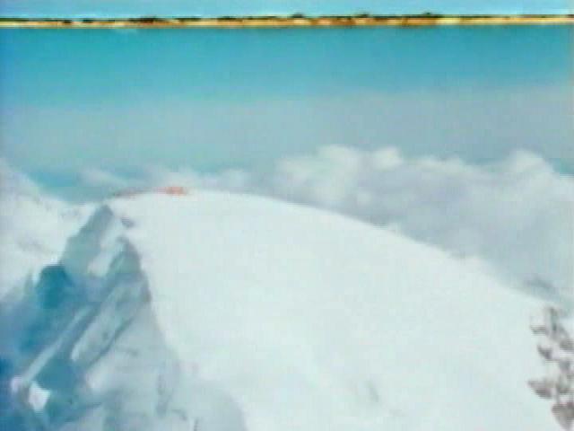

    Horizontal noise?? across the top
    Jan 2008
    Watery horizontal line midway down
    Jan 2008
    Brighter horizontal streak near the top.

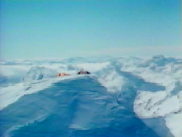

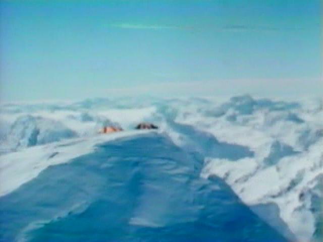

    Some of the issues look like tape 'dropouts'. Faults in the magnetic structure of the tape. You can correct these but not through filtering. You achieve this by cloning the colours around the artifact and painting over it frame-by-frame.
