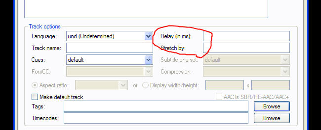

i tried using the STRETCH but i dunno what im to out into the box so i put 1 and no difference....
the sound needs stretching out about 1 second

If you mouse over the empty box, it gives you instructions on "strech"

in MKVmerge will -1000 in the stretch audio box shrink it by 1 sec?

so can i shrink the AC3 by 1 second ? (what do i put in the box in MKVmerge)

hanging the mouse over the stretch audio doesnt make any sense to me lol
floating points? 1200/1253 fractions?
means nothing to me..normally they would have an example -
I think you have to use a fraction like 999/1000 for shrink in MKVmergeGUI (I think decimals work too) - so this would be 99.9% as long as the original audio in this exampleOriginally Posted by snadge

so will i put "99.9%" in MKV merge stretch audio? -
If it's off by only 1 sec in a 1hr, 30min film, you're going to have to use something like 9999/10000 (you could calculate it out with a calculator before doing it so you don't waste 10hours on conversions
It says use fractions, so I'd use fractions
