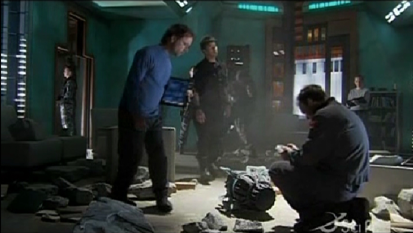

Anyways I just encoded some shows in better than twice the normal time using powerdirectorpro. Made a DVD (using the same process as I have countless times before with good results) but the output quality wasnt so nice.. noticable square grid type effect over the whole picture.
Dual cores encoding video have any issues? Or does anyone know anything of this?

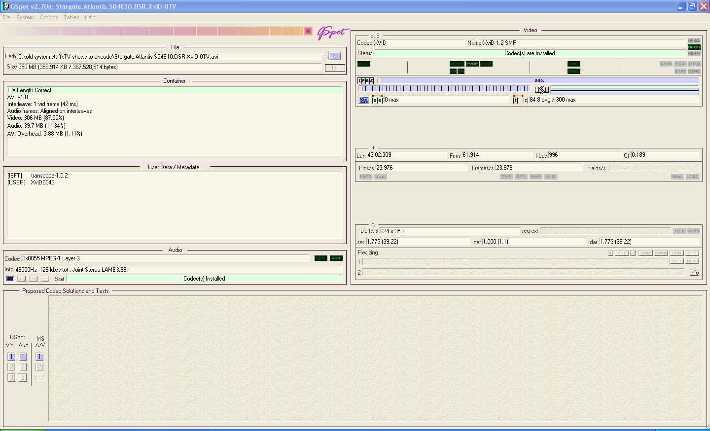

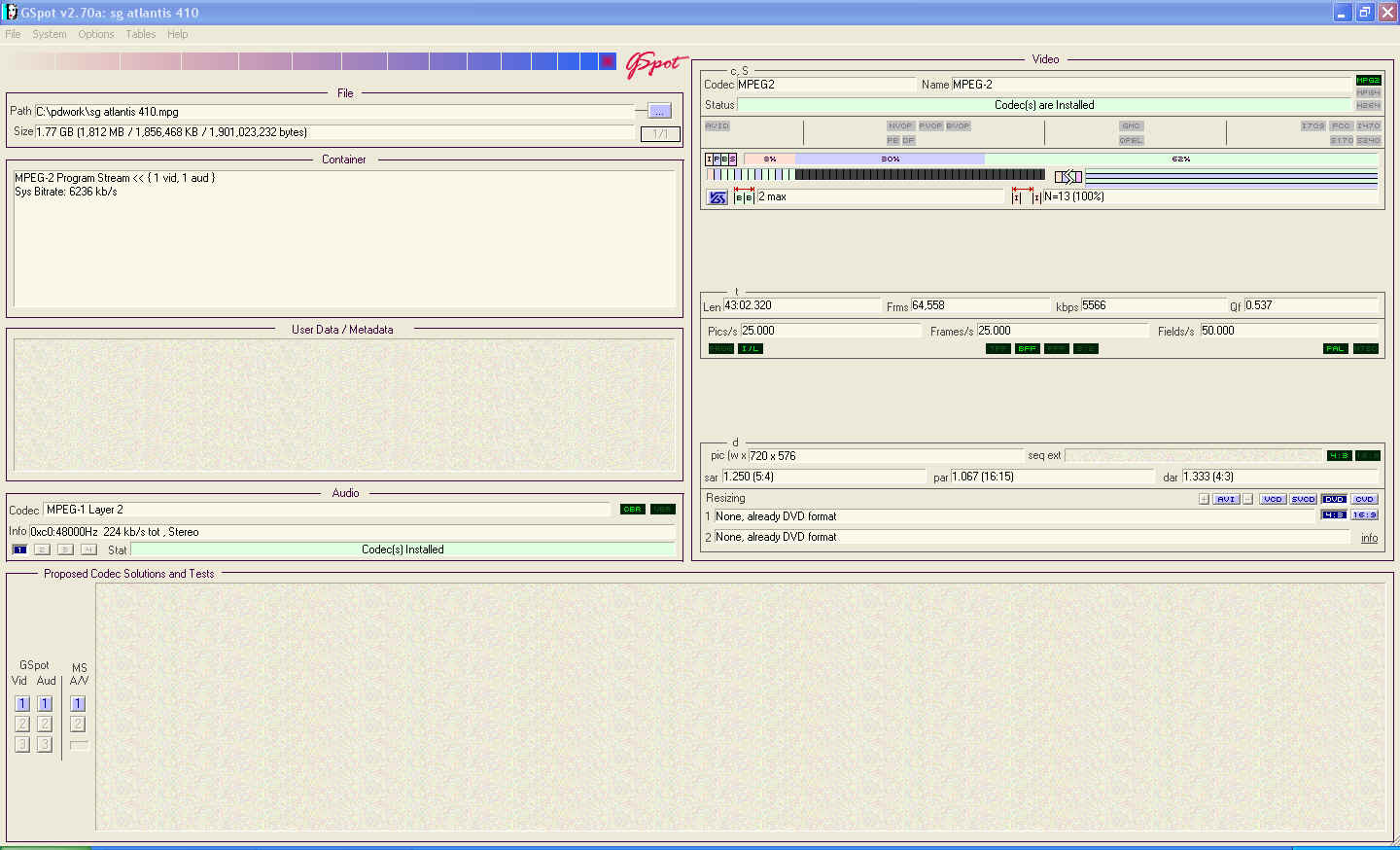

the info gunsl1nger would like and the same info for the source would be helpful.

It looks like bad scaling by the player to me. Have you watched it on TV? Look bad there too?
It actually looks worse on the TV.

I've never used G-spot, i'll have a look at that and try to get the relevant info posted.
exactly what do I need to do with G-spot(might be helpful

I suspect that some settings with powerdirector pro were different between your encodes. The output file bitrate seems fine
It looks like you have tried to encode an XVID TV episode to DVD compliant MPEG-2.

from the snaps you are going from ntsc to pal. not a problem but you may notice some jerkiness from the frame rate conversion.
you didn't use one of powerdirector's default profiles did you? the audio is mpeg which means you changed something because they all default to ac-3. try using the mpeg-2 dvd-HQ profile and see if the video doesn't come out better. it will bump the bitrate up to ~ 8000.--
