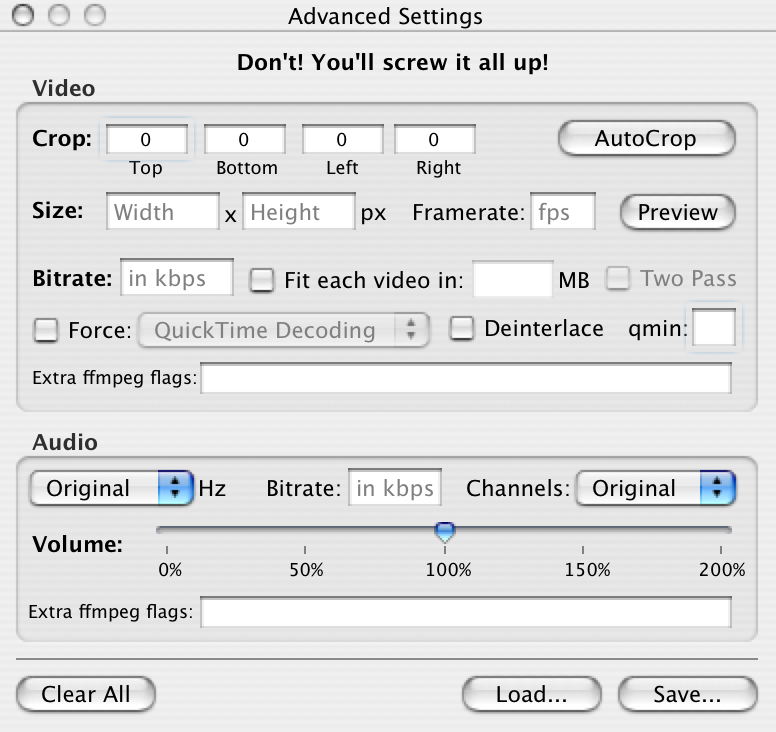

    okay just did everything in visual hub as per your instructions and it worked great.
    my only issue is that the dimensions of the video is pretty big - too large to embed in my website.
    so how do I go about creating a smaller size (dimension wise) version using visual hub?
    :: ehmjay.

  11. I'm a MEGA Super Moderator Baldrick's Avatar
    Change the width and height?

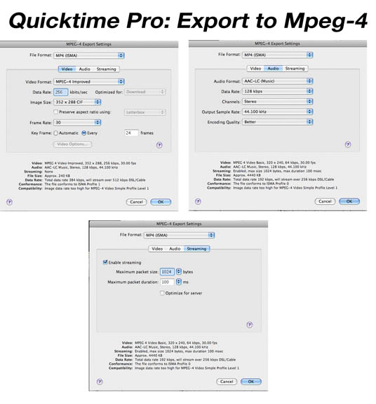

    you can set the video to Streaming start when encoding from
    Quicktime Pro, not from Visual Hub.

    5. Take the trailer or Highlight reel, no more than 1 min in length,
    and export it from QT Pro as the following:
    6. Then, code my HTML page.
    7. upload the HTML and the .mp4 file onto the web server
    You can substitute QT Pro with Visual Hub, just tweek the settings in
    the MP4 preferences to match.

    so 50MB is the magic ceiling....
    ok so what you do is dial down the mp4 settings to get video under 50 mb.
    using my example:
    Audio: tweek to 32khz 128kbps audio
    video: 128kbits data rate, at 320 x 240 with a 15fps rate with auto keyframing
    Streaming: Enable Streaming, Max packet 512bytes, with max duration of 50ms
    that should put it under 50mb for your site.
